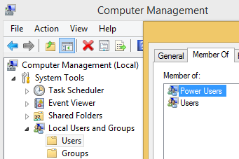

#6 2014-08-14 15:35
- Posts: 1,918
Re: Networks drive are not unmapping
Please check the groups your user belongs to:
Control Panel > Administrative Tools > Computer Management > Local Users and Groups > Users > Preferences of the affected user > Member Of
Please post the listed groups.
#7 2014-08-14 15:57
- Martin
- Member
- Registered: 2014-08-04
- Posts: 6
Thanks i solve giving netsetman admin rigths when boots.
