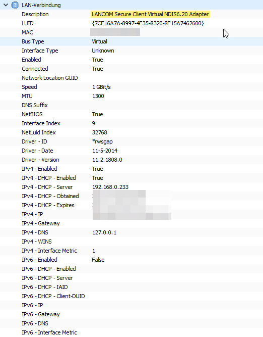

using the lancom advanced VPN client here beside netsetman and cannot select the dynamic adapter that is created by the LANCOM NCP client ...

Thanks for the screenshot, but please always state the version you are using.
Not sure what you mean by calling it a "dynamic adapter". Is it only present when a VPN connection is established or is it a constantly available adapter that is also listed in the Windows Network Connections dialog?
Was the adapter already there. when you ran the application? If not, either restart it or right-click on the adapter selection and choose "Refresh".
We are not sure, but the problem might also be that the Interface Type is stated as "Unknown". Once the other questions have been clarified, we could continue here.

Thanks for the quick reply - And my bad .. version 5.0.5 from 2021-02-04 it is.
A bit unfortunate to call it dynamic from my side. It's a normal virtual adapter shown in the network connections like this ...
The adapter was already there when I ran the application. It's listed as disconnected of course when not connected to the VPN. But even when connected netsetman does not pick that one up.

The problem is that your adapter does not provide the data that we would expect from a normal network adapter. In a first step we are using a Windows API and in a second step we read additional information (that the API might not have provided) from the registry.
In your case, the bus type is not provided at all and the interface type is stated as IF_TYPE_PROP_VIRTUAL (= proprietary virtual) which is something that is currently not considered worth including as a relevant adapter. There are lots of virtual interfaces in every system and lots of different interface types so we need to filter them.

1) Task to carry out is dynamically changeing the used DNS on the fly.
2) It is only visible by using "get all"

If the adapter is not in the normal Adapters Details list, then there is a significant chance that even if you could select it in a profile, it wouldn't be possible to change its IP settings.
