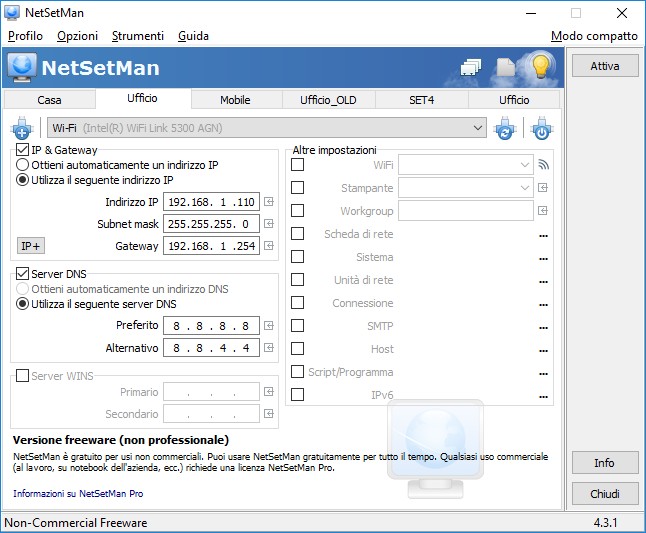

This is my actual profile set (forced IP, Gateway and DNS)

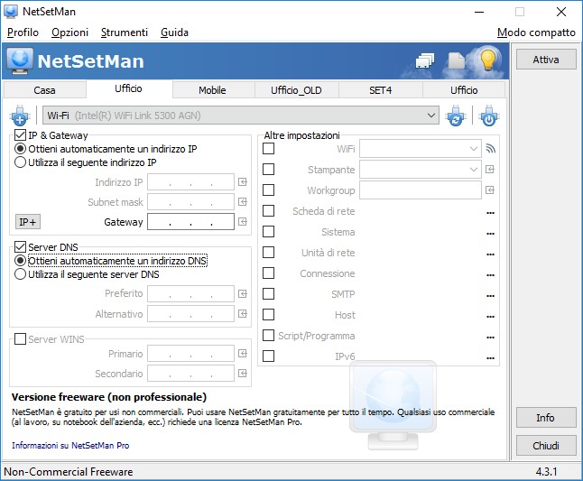

And this is my regular "Ufficio" profile (DHCP)
But with DHCP activated my IP Address become 169.254.18.161 and I don't know why! On my other PC and smartphone DHCP works well.

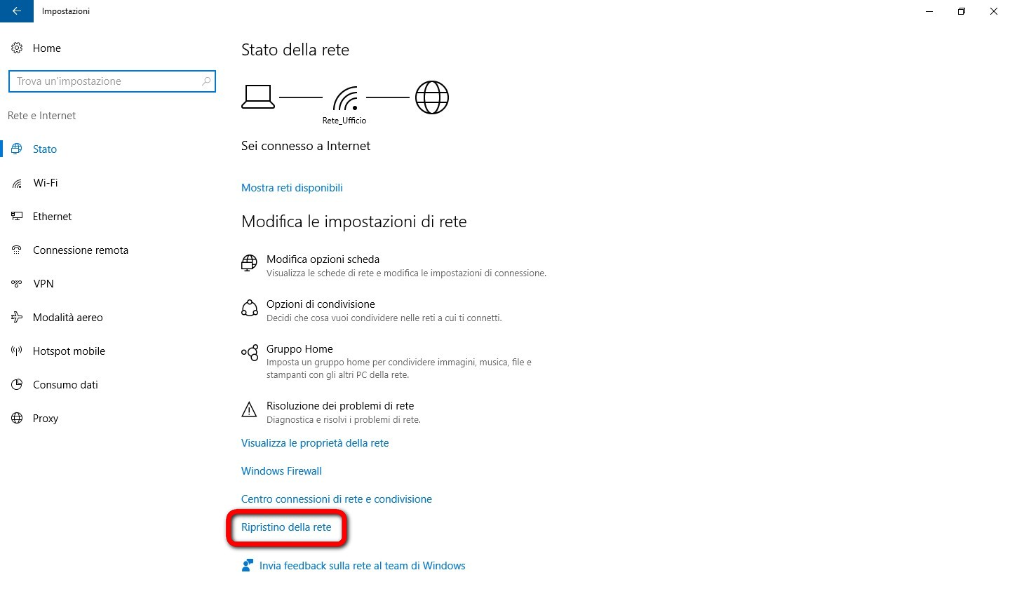

This command (italian UI)
Found the procedure here
Microsoft support
