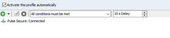

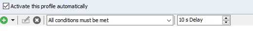

I try to define a HomeOffice profile which must autoswitch when a VPN is activated.
For that, I use Pulse Secure adapter status:
Unfortunately, the condition is erased when Netsetman is launched, after each boot :
Is this normal? How to have a profile depending on the VPN connection?

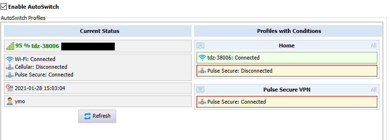

Here the scenario:
Fresh start, after booting:
- Profile "Pulse Secure VPN" has no condition
- Profile "Home" has only one condition, based on Wi-Fi
Showing that there is no possibility to add a condition based on status of adapter "Pulse Secure".
Connecting the VPN
Adding a condition based on status of the adapter "Pulse Secure"
Quitting NetSetMan
Lauching NetSetMan: Conditions based on status of the adapter "Pulse Secure" were not saved and do not appear.
